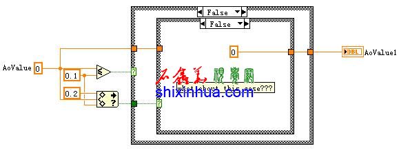

    有网友提问:
    Hi
    I like to do the following statements in LabVIEW,
    IF AoValue<=0.1 THEN
        AoValue1=(AoValue-0.0060)
        ELSEIF (AoValue >0.1) AND (AoValue<0.2) THEN
         AoValue1=(AoValue-0.0035)
    ENDIF
    Pls help with this
    Thanks
    网友答案:
    陈树学:labview编程技巧-----令人无奈的IF ELSE

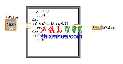

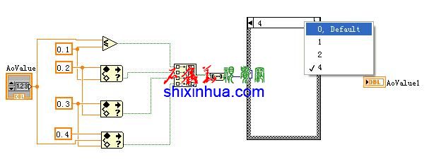

    这是个两层的IF ELSE结构,如果数据分成10段那,那上面的判断结构将无法实现了.(另外,他的AOVALUE应该是个输入控件)
    比较好的解决方法:
