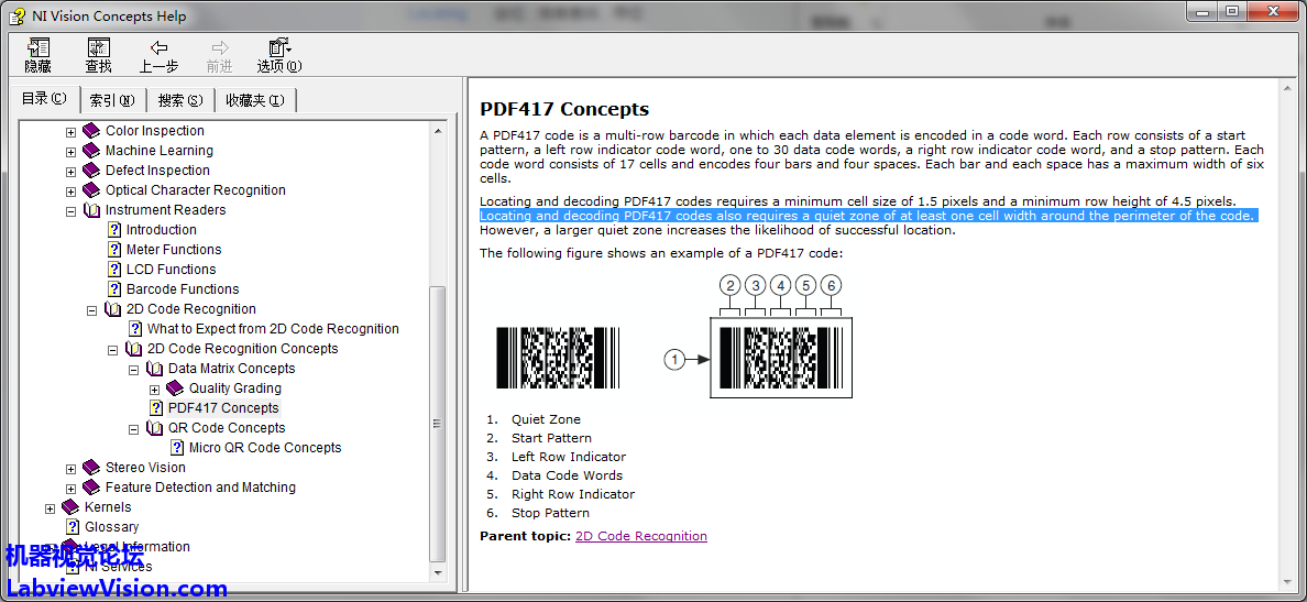

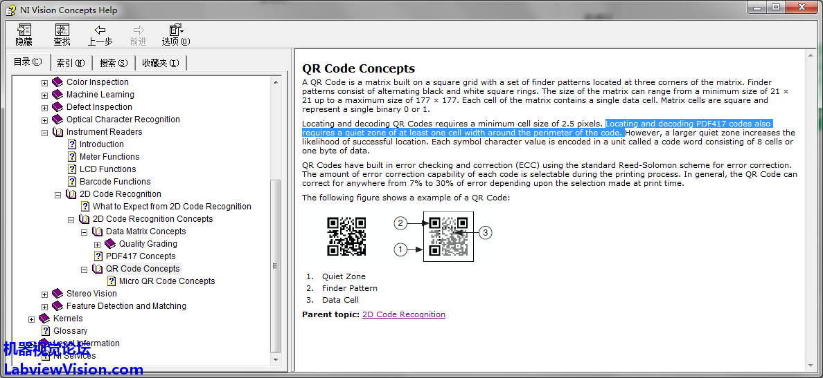

    Locatingand decoding PDF417应该是Locating and decoding QR Code
             NI视觉概念帮助的QR Code Concepts中,Locating and decoding PDF417 codes also requires a quiet zone of atleast one cell width around the perimeter of the code(定位和解码PDF417码需要在码的周围具有至少一个单元格宽度的静音区)。这里的定位和解码PDF417应该是定位和解码QR Code。这里的内容应该是文档编辑人员从前面的PDF 417 Concepts复制过来没有修改相关名称导致的:
    PDF417中的Concepts才应该是Locating and decoding PDF417
