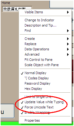

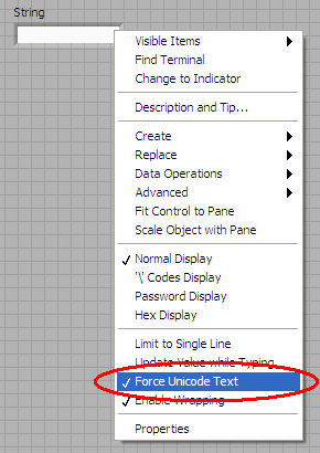

    Force Unicode Text is a property which can be enabled and disabled on the string control using the context menu of the control or indicators.
    Figure 2: Setting the Force Unicode Text property on a string control

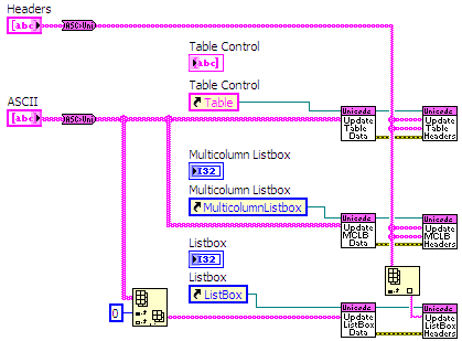

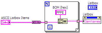

    Listbox, Multicolumn Listbox and Table
    The Listbox, Multicolumn Listbox and Table controls have different behavior in terms of processing Unicode strings from the rest of the text elements described previously. These controls so not use the InterpretAsUnicode property. Instead they look for a BOM (Byte Order Mark) on any strings passed to them. If a string passed to these controls starts with a BOM (either 0xFFFE or 0xFEFF) then the string will be handled as Unicode. This allows you to mix both Unicode and ASCII strings in the same control. The examples include subVIs to pass strings to these controls and mark them as Unicode using the BOM.
    Figure 3: Adding the BOM to Unicode strings to update a listbox

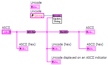

    Programming Unicode in LabVIEW Converting ASCII Strings to Unicode
    Included in the examples are two very simple VIs to convert an ASCII (MBCS) strings to Unicode and vice versa. These VIs use functions provided by Windows to detect the current code page used for the MBCS and handle the conversion.
    Figure 4: Converting between ASCII and Unicode strings in LabVIEW

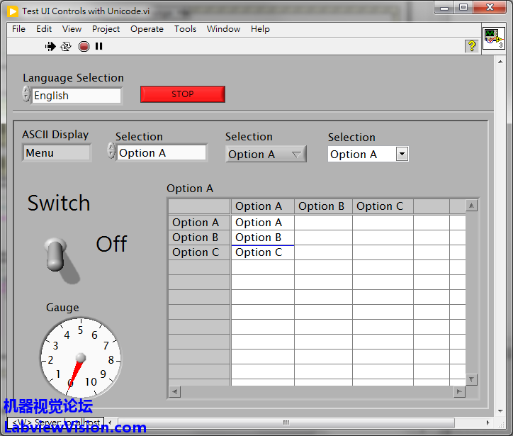

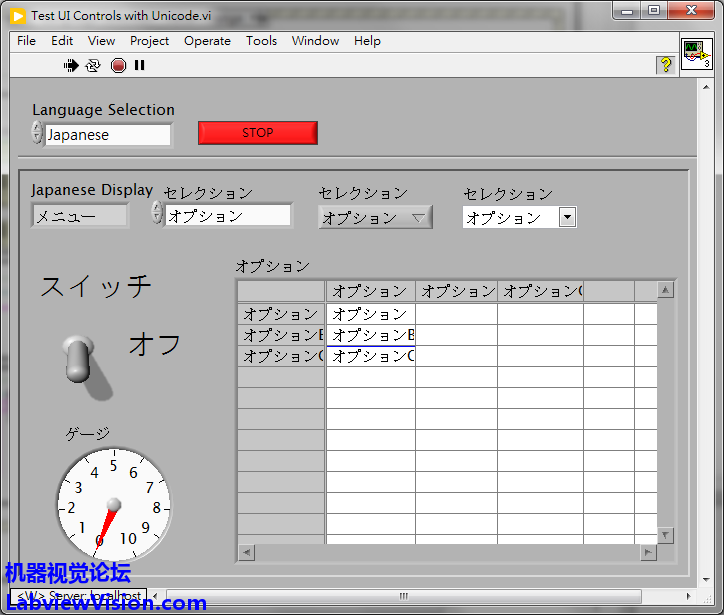

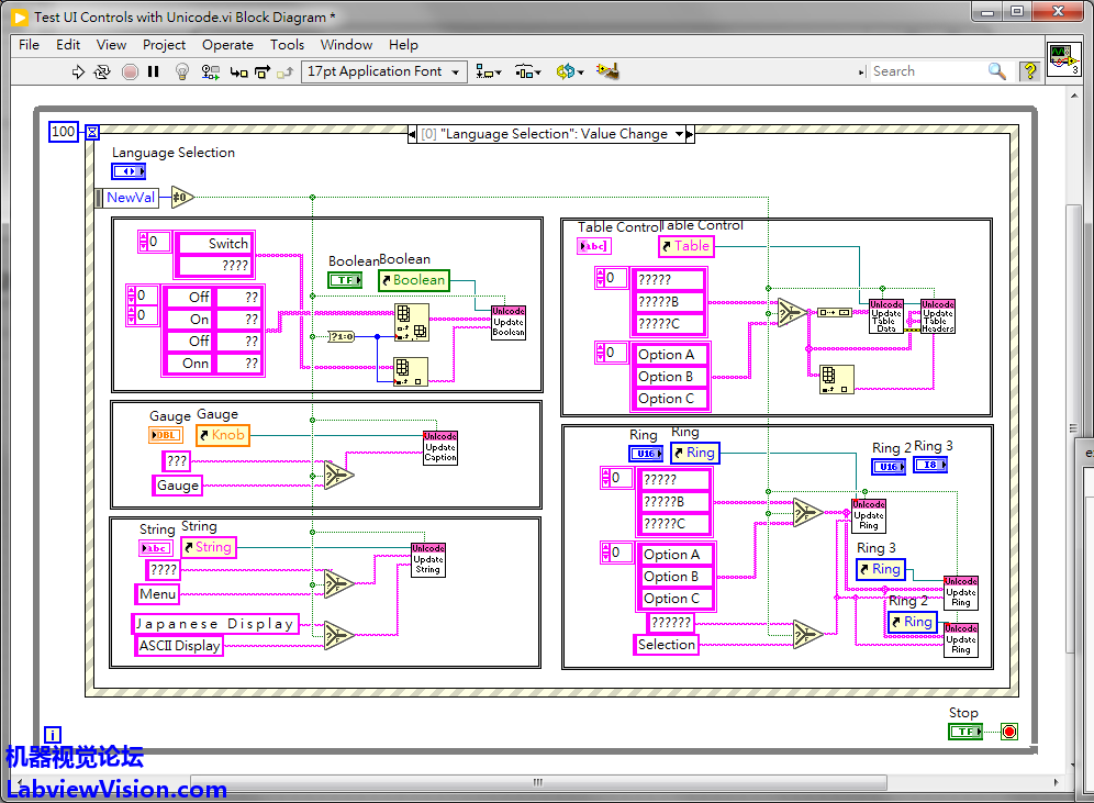

    Displaying Unicode Strings on Controls and Indicators
    The attached project includes a number of examples showing how to display Unicode strings on different UI controls and indicators. For each of these control types subVIs are included to pass strings to the control and their caption and specify whether the string should be treated as Unicode or not. The following UI controls and indicators are supported with specific VIs:
    • Caption of any control or indicator
    • String
    • 1D String Array
    • 2D String Array
    • Boolean
    • Ring
    • Listbox
    • Multicolumn Listbox
    • Table
    Using control properties you can also access these controls inside of other data structures such as a cluster.

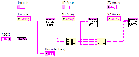

    Figure 5: Converting an ASCII string to Unicode and display it on a string indicator, 1D string array and 2D string array
    Figure 6: Converting an ASCII string array to Unicode and display it on a Listbox, Multicolumn Listbox and Table

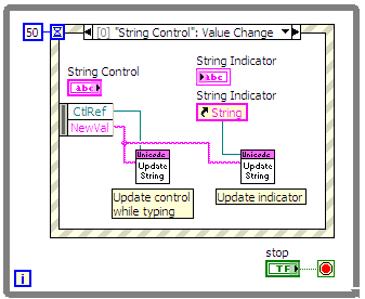

    Reading Unicode from a String Control
    In order to read Unicode strings from a front panel string control there are a number of settings and that need to be made:
    1. Enable the Force Unicode Text property of the string control from its context (right-click) menu.
    2. Enable the Update Value while Typing property of the string control from its context menu.
    Figure 7: Enable the Force Unicode Text and Update Value while Typing properties
    3. Add an event case to the Event Structure for the Value Change event of the string control. In the event case wire the control reference and new value from the event to the Tool_Unicode Update String VI as shown in the following diagram. This will update the string control as the user is typing to keep the InterpretAsUnicode property set to Unicode, while entering ASCII characters.
    Figure 8: Event Handler for the Value Changed event of the string control

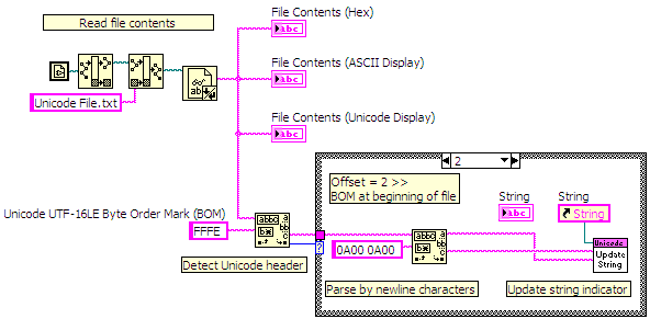

    When reading and writing text files it is important to know if the contents of the file is ASCII or Unicode. The Read from Text File function in LabVIEW does not know whether the contents of the file is ASCII or Unicode. Therefore you need to check to see if the file contains a BOM (Byte Order Mark) at the beginning of the data read from the file and then process the data accordingly.
    Figure 9: Read a Unicode text file and process

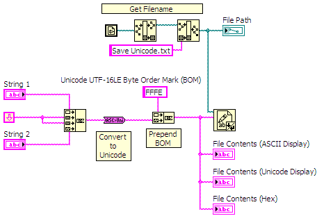

    o write Unicode text to a file, convert all your strings to Unicode and then prepend the BOM before writing the final string to a file using the Write to Text File function.
    Figure 10: Write Unicode text to a file

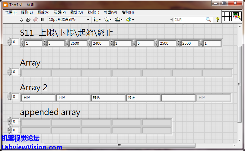

    上面的介绍是NI官方提供的。这种,是在能正常显示相关本地语言时,部分控件无法显示的本地语言的问题,就要使用工具包,将输入语言转换为本地语言。但是要如何先显示成本地语言呢?例如,我们通常使用的简体操作系统,简体中文版LabVIEW,编写的代码,要在繁体操作系统上显示简体中文。或者是湾湾的朋友们编写的繁体版VI,要如何在我们的简体LabVIEW中显示呢?下面来探讨一二。
    目标电脑Win7SP1简体中文版64位,要显示湾湾朋友们编写的繁体vi

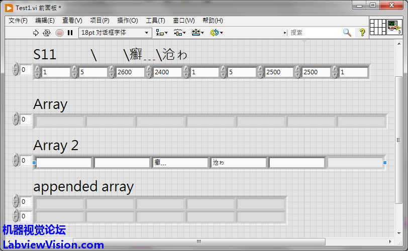

    简体中文操作系统,简体LV打开繁体vi,LV界面能正常显示简体中文,代码部分的繁体乱码显示

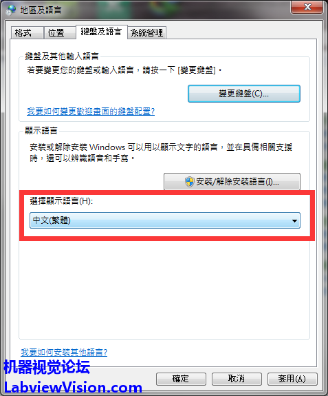

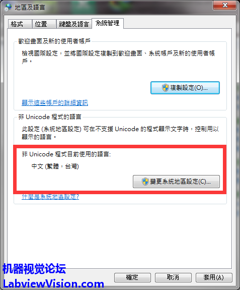

    首先,找到WIN7SP1的繁体中文语言包,并安装。
    然后在控制面板中,地区和语言中四个选项卡中和语言相关的,全部换成繁体湾湾区。

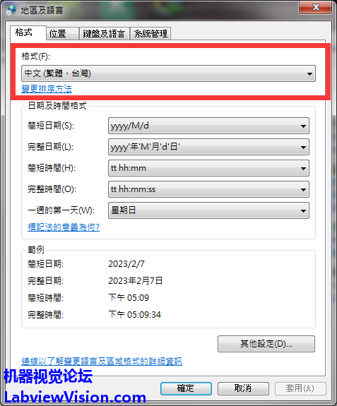

    格式选项卡,格式切换为中文(繁体,湾湾)

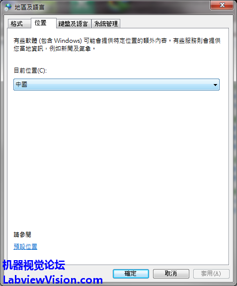

    位置选项卡,这里仍然是中国(无论是简体、繁体,都是一个中国,这个原则不能变。如果是英文版的操作系统,则需要切换为中国)
    键盘和语言,选择显示语言中,选择中文(繁体)。键盘中选项,则看你需要不需要变换为繁体输入,如果不需要,则保留简体输入,不需要修改。
    系统管理中,非unicode程序的语言,这里也设置为中文(繁体,湾湾)
    设置好地区和语言后,重启操作系统。然后再次打开LV,打开湾湾写的繁体vi

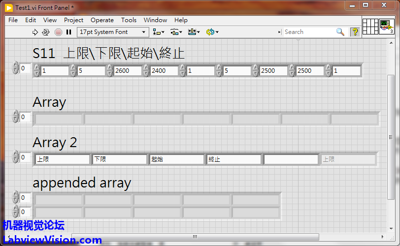

    简体32位LV中,可以正常显示编码中的繁体了,但是简体中文的LV界面则无法正常显示
    英文64位LV中,可以正常显示编码中的繁体,也可以正常显示英文界面。
    所以,在其它语言环境中,打开非本地语言的vi,比较可行的方法是使用英文版的LabVIEW,然后将地区和语言都设置为本地相关的。

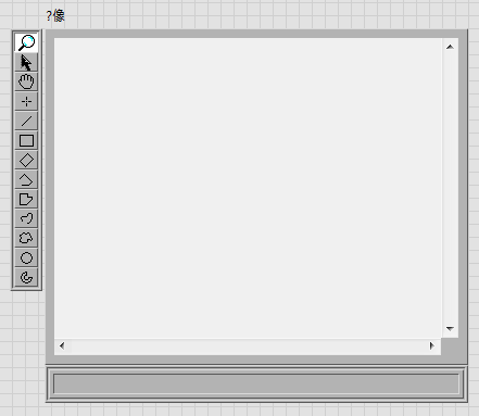

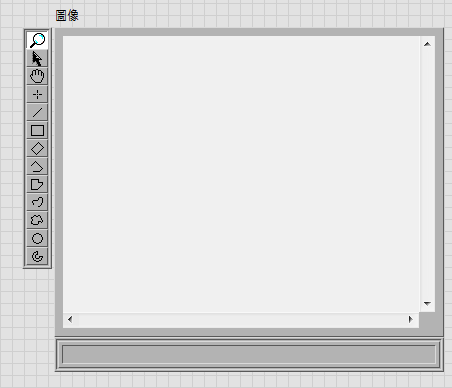

    到此,如果新输入非本地语言,则可能无法显示:
    简体的“图像”无法显示
    可以將輸入法切換為繁體輸出“圖像”,則正常顯示

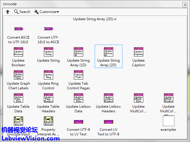

    如果遇到部分控件无法正常显示本地语言,可以尝试使用附件中的ni_lib_unicode-2.0.1.5.vip工具包,来安装一组unicode转换vi:
    unicode转换vi
    转换不同语言
