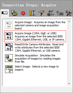

    2.   Acquire Image(1394,GigE,or USB):Acquires an image from the select IEEE 1394,Gigabit Ethernet,or USB camera.
    VBAI Help:Configures an acquisition from an IEEE 1394 camera, GigE Vision camera, IP camera, or DirectShow-compatible USB camera. To acquire images from a DirectShow-compatible USB camera, the camera must be connected to a Windows system. Refer to Acquire Image (1394, GigE, or USB) FAQs for information about DirectShow-compatible USB camera support.
    采集图像(1394,GigE,或USB):从选择的1394、千兆网,或USB相机中采集一幅图像。可以从1394相机、千兆以太网相机以及USB相机中采集图像。根据以往的经验,国外的Basler、ImageSource、Smartek,国内的大恒相机都可以通过此项进行图像采集。
